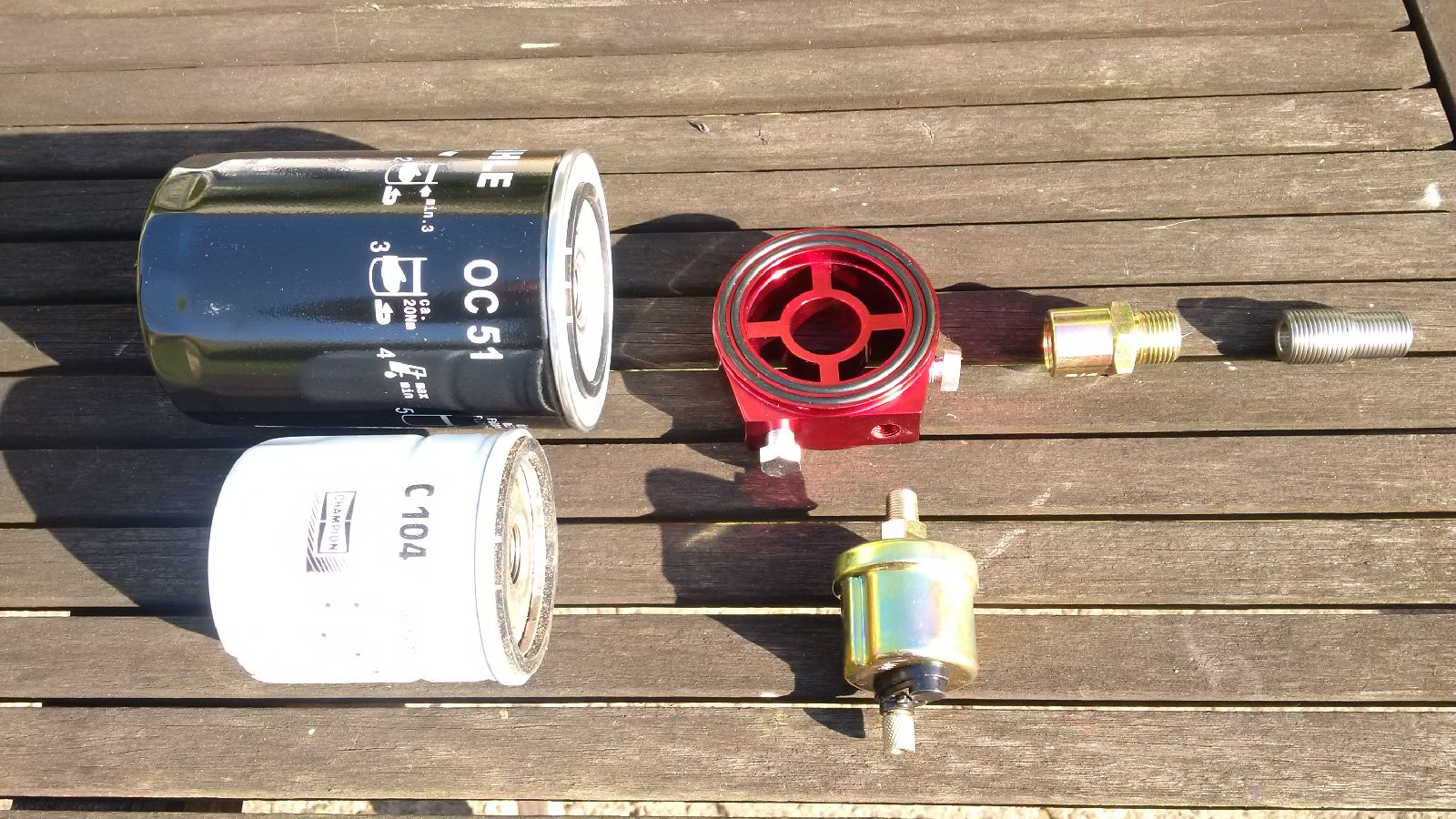

I have both the larger oil filter & a oil temperature gauge.
I drilled & tapped the 2cv oil filter housing out to 3/4" unf & hade a stub by drilling a length of 3/4" unf threaded rod.
Then you can use a readily available (inexpensive) oil filter sandwich gauge adaptor for this thread and have a large choice of filters.
I use a Ford Fiesta filter (small) in the winter and a VW Passat 1.9 (large) in the summer.
Plenty of room on a Pembleton, you will need to check for clearance on your 2CV chassis.

I suggest fitting a temperature gauge before modifying for extra cooling either in a sandwich plate like in a preceding photo or use a sender in the sump plug. I have a pembleton with 2cv engine, the std. 2cv oil filter and standard oil cooler (with fan removed of course) and find the engine usually runs a little cooler than ideal - about 60C rising to 80C in hot weather and up long hills.
I installed a sandwich plate between the filter and crankcase but had a bad experience with a cheap electronic sender and gauge. The system gave a reading about 10C high and then failed after 3 months. I drilled the electrics out of the sender and fitted a capillary gauge. This is accurate to 2C and has worked fine for about 2 years so far. The one I bought is like this -

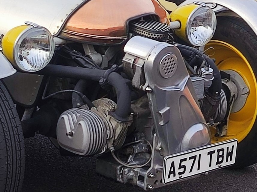

I also have the latest Burton finned rocker boxes, these lowered oil temp by 10 degree C in any given conditions, I think I now have enough headway for a 650cc kit.
Pembleton SuperSport 602cc

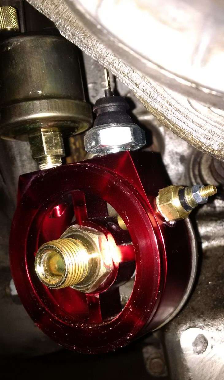

Howard,
The extra senders tuck away neatly on my car, using a standard adaptor flange.
The three senders are oil pressure, supplementary 30psi oil pressure warning light (to warn you before it is too late!) and temp sender.
