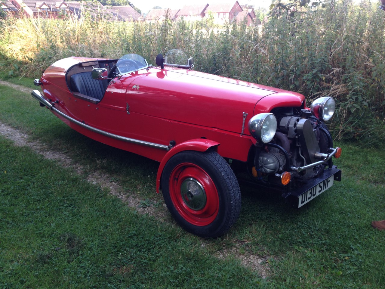

Hi Guys thanks for you reply's re Oil Temperature / cooling / gauge etc. I have had to put that on hold at the moment as I now have a more pressing problem.
Driving along the other day it started to stutter and power dropped considerably. I got it home ...just !
It runs ok in the garage if I keep the revs up but won't idle and back fires some-what into the carb. Spark plugs and ignition seem fine . The inlet and exhaust valve gaps were a bit tight ! Adjusted but no better. I I got a compression tester on the off side head ( 130/140 psi ) but there is steel work obstructing my access to the other head. However I brazed a connection into an old spark-plug to get access ...... showing an iffy 40 psi.
I'm reluctant to take the head off but this sounds like a burnt out valve to me.
Any thought or suggestions would be most welcome
Dave Ward
Dave Ward

After more investigation .... checking again the plugs, leads, carb, and another compression test ( 100 O/S ... 90 N/S ) there was nothing obvious .
So I tried running with just one spark lead connected ...O/S runs reasonable , N/S runs but doesn't sound quite ride with occasional back-fires ??? !!!
Another issue I have discovered is the breather / oil filler return has been blanked off and if the cap is opened while running there's quite a bit of pressure in there and it blows oil droplets out !!! ... I'm obviously going to have to refurb the breather but what do you guys do regarding the return pipe ?? I only have a small pancake air filter unit and while I could modify it to take a return pipe I suspect it wont like this sort of pressure being injected into it.
Having studied the problem regarding removing a head I'm going to need to cut the body work out a bit !!! So last resort
Any suggestions would be much appreciated,.
Thanks Guys
Dave Ward
Thanks Guys
Dave Ward
