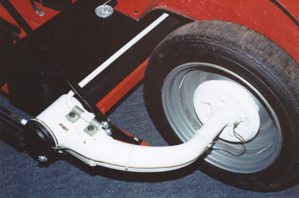

My Lomax 223 has fixing points on the top of all 4 suspension arms (including the inactive one) for an anti roll bar.

Here is the original ARB as fitted to Lomax. A Citroen Ami I believe.

Rocketman, The photo you posted is of the Lomax rear ARB.
The photo posted by Howard is of the Lomax front ARB (which is a copy of the AMI setup).
The ARB's provided by Lomax were manufactured in the Uk from heat treated Spring Steel.
PS. Some early 2CV's had torsion suspension (in place of the underslung dampers etc). Kits for these may well have been offered with a duplication of the rear ARB for the front.

Here is the Lomax 223 rear arm arrangement. One arm is extended to centralize the wheel while the other is cut at the point where the square section becomes round. Both near and offside rear springs are retained and arms connected by a bar as shown. May have been a modification on later kits?
