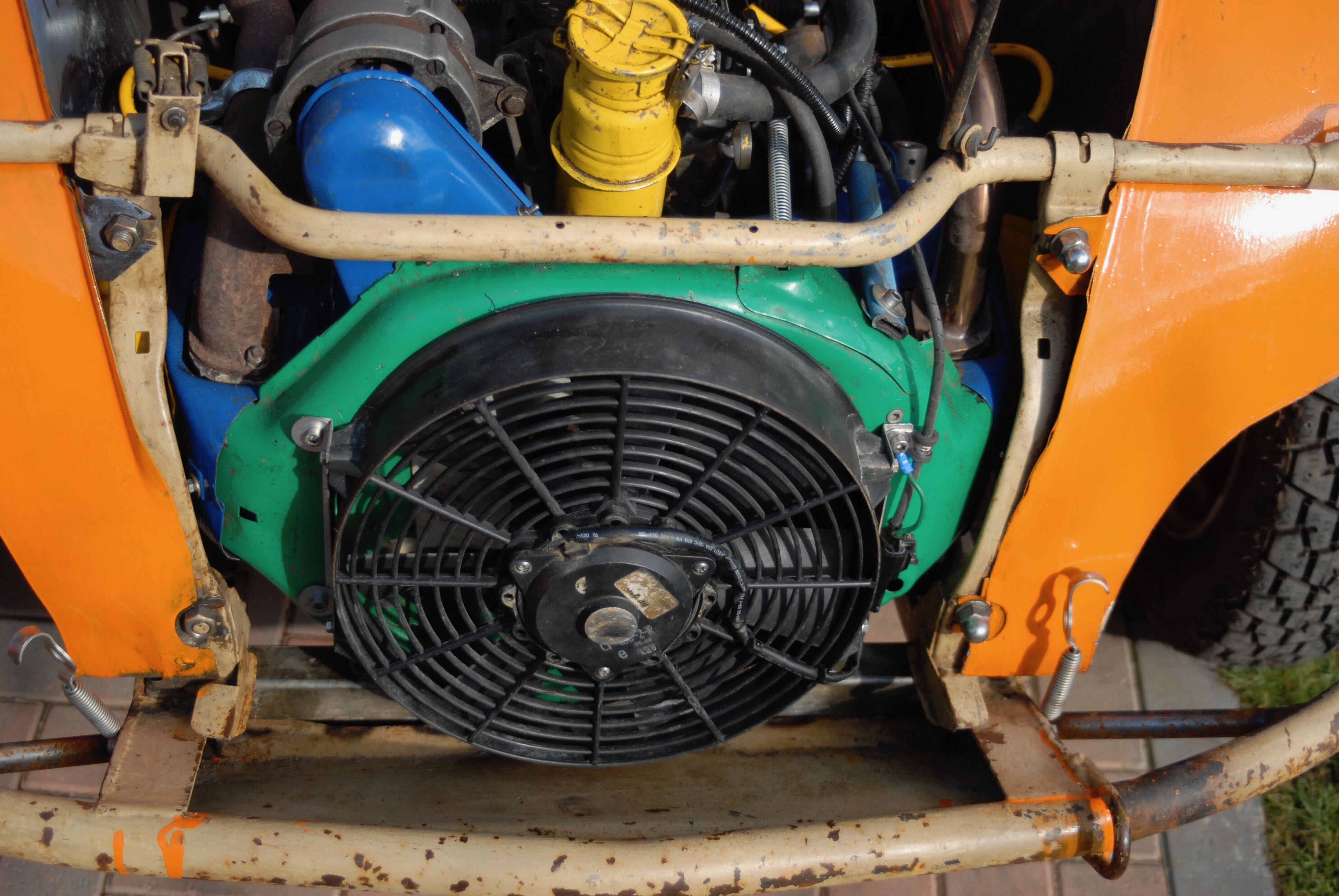

If i can find the bits in the photo , will dispatch for P&P

The fan in the picture consumes 3 or 4 amps from memory thus 48 watts!

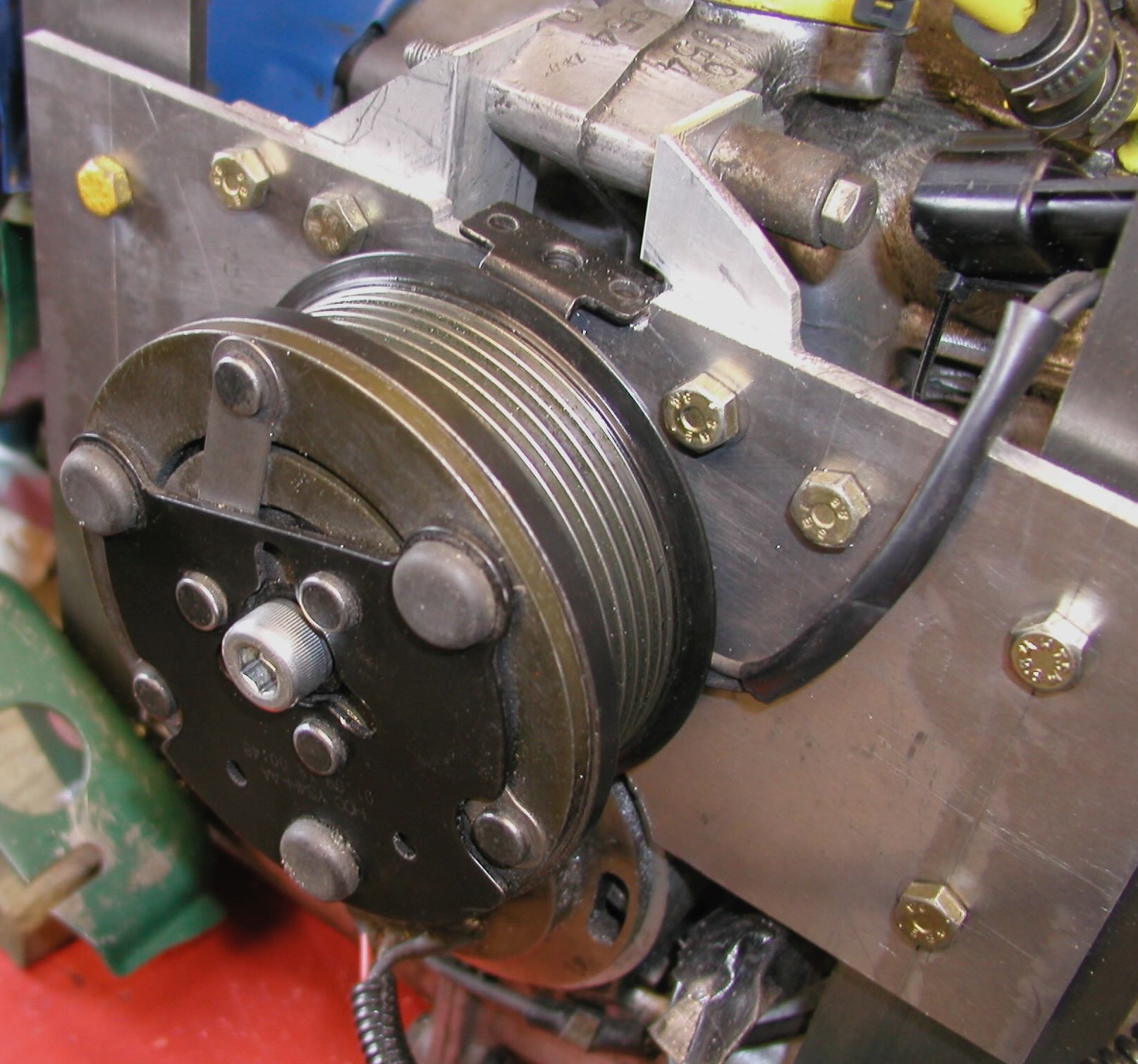

I have fabricated a 2cv fan on A/C magnetic clutch.
Was controlled by a thermal switch, Fan came on when with high revs, caused the bolt in the crank to tighten and seize:):)
(in the shed somewhere?)
