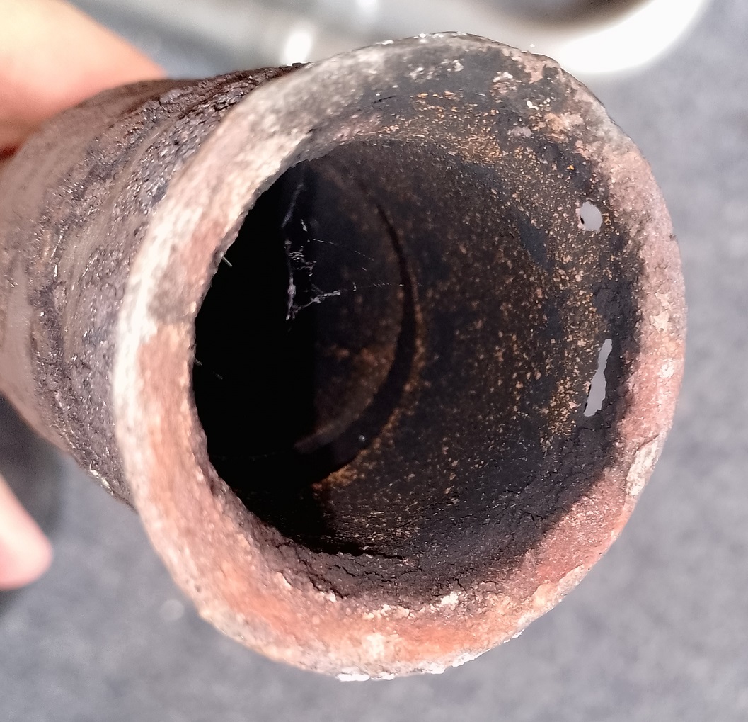

Almost had my Falcon bodied three wheeler for two years and been a club member for a year but only just got around to posting as it's been keeping me busy as a rolling rebuild.
I noticed a pin hole in exhaust mounting flange where it meets the exhaust manifold last weekend, which turned out to be two holes and after removing both separate side pipes it looks like it was also leaking out of pretty much each joint!
So now I get to learn how to make a custom exhaust.
Pipe, bends and clamps can be bought easily enough from ebay but does anybody have an advice on how to make or get a pair of the flared ends I need to match the stock manifold?
Any advice on pipe diameter would also be helpful. It's setup to run a pipe down each side as it's too low to use the stock collector box under the gearbox.

Exhaust flange for manifold.
- Exhaust-Holes-Forum.jpg (336.26 KiB) Viewed 10470 times
Re: Exhaust flange for manifold.
Hi.
If I understand your post correctly, you're after the pipe that are inside the exhaust heat exchangers?
I have 2 that have had exchangers removed.
Any help?
Any help?

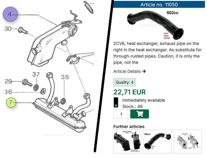

I think those are the ones I need.
I've just had a look on https://www.franzose.de as it has the exploded diagrams and you've taught me that the front box doesn't connect through the heat exchangers as I thought, but to them. Good thing I didn't just rush and buy one of them to chop the ends off!
Am I ok to drop you an e-mail about them?
- HeatExcPipe.jpg (88.66 KiB) Viewed 7668 times

Note for anyone reading this in years to come:
The pipes in the heat exchanger have the same flange on each end, so you can make up two ends from one pipe.
However due to the shape of the pipe one end has a decent amount of straight behind it and the other end has just a short run.
