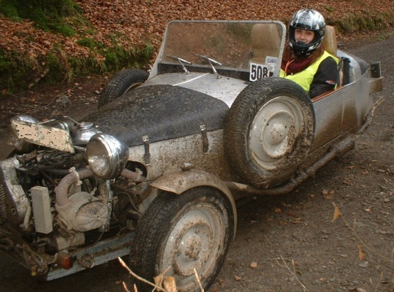

- Exeter Trial 2013 Fingle
- LDT Trial.jpg (122.2 KiB) Viewed 23863 times

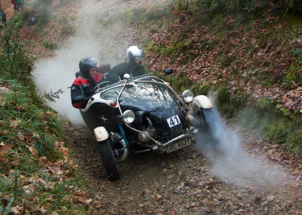

- Exeter LDT 2013 Fingle.JPG (192.2 KiB) Viewed 23863 times

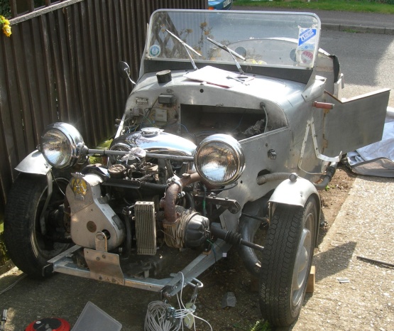

- Work in Progress
- WIP April 2012.JPG (120.06 KiB) Viewed 23863 times

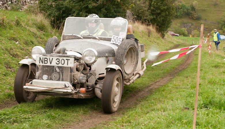

And one more photo for encouragement.
Cheers Paul

The second outing on an MCC classic trial, in this case, the Edinburgh Trial 2013. Just a little tempter to encourage other three wheelers to have a go. As I stated previously, if you're not sure of your ability or the suitablity of your car, enter class 0, which has the easier sections.
Photograph copyright Charlie Wooding
The new alloy box and bumper on the front puts about 30 lb ballast (jack, tools, tyre levers) at the front. Grip was certainly improved, but most of that may have been due to overhauling the carburetter (thanks to Ken Hanna). We managed to ruin the left front tyre by putting a rock through the tyre wall, but that's all part of the experience. Looking at the photo, we could have lowered the tyre pressures even further for this section, but that's the benefit of hind sight.
Photos of the trial can be seen on http://charliewooding.co.uk/v/photos/49 ... C139046402
Regards Paul
Regards Paul
