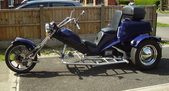

Could you post a picture of the whole trike? I'm wondering what would stop you having a solid lever (with suitable bends etc) like a suicide shifter on a Harley?
Re: Cable operated remote gear lever?

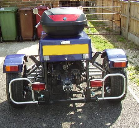

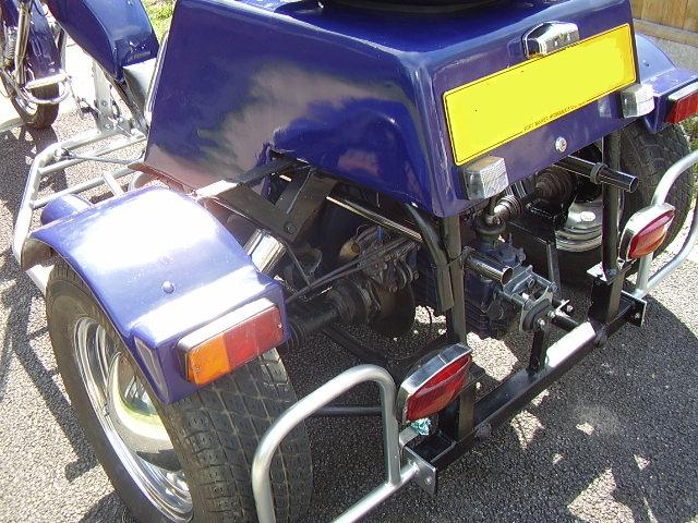

Hello Geoff,
These are photos I took today. The gear lever runs through a tube under the bodywork above the engine from the left hand side. I've had 3 nice blokes down from the East Coast branch of the CSC and they think that the way I've been told is the best way to sort it, ie shorten the gear lever and move the linkage down 6 or 7 inches to give less travel.
Dave
Dave
- Latest May 2013 (3).JPG (94.17 KiB) Viewed 12224 times
- Latest May 2013 (2).JPG (59.22 KiB) Viewed 12224 times
- Latest May 2013 (1).JPG (57.47 KiB) Viewed 12224 times
Dave,
Can't help but notice from the photos of the trike, that the brake calipers have been assembled back to front. Not a huge problem, but under heavy breaking, the brake pads are being froced out of the calipers instead of into them.
Those, more knowledgeable, will no doubt chip in, but I'd not be comfortable with them arranged this way!
Discuss?
Callum
Discuss?
Callum
Dave - I would agree with Callum - it's worth swapping them around. There is a trick you can use so that you don't have to split the callipers. Remove the brake pipes as appropriate. Then remove the front-most calliper mounting bolt. You need to take that bolt out completely then just crack the other one off so that you can rotate the calliper up about 60 degrees. Re-insert the bolt and then put one of the gearbox/engine nuts on and tighten it up. You can now remove the second bolt and the calliper will stay together. Fit it to the other side by reversing the procedure.
