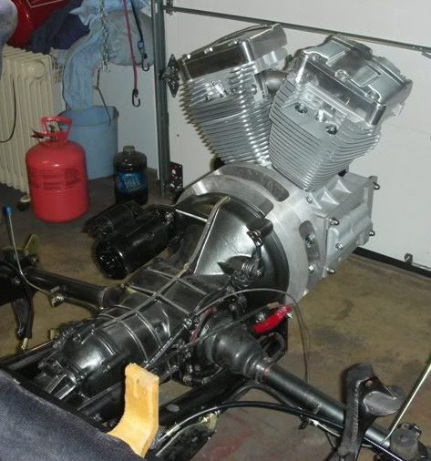

Here is a Harley engine coupled to a VW box using a clutch / thrust bearing adaptor. Nice job but would protrude well in front of the driving wheels in the case of a FWD.
- twincambfront.jpg (52.38 KiB) Viewed 14345 times
