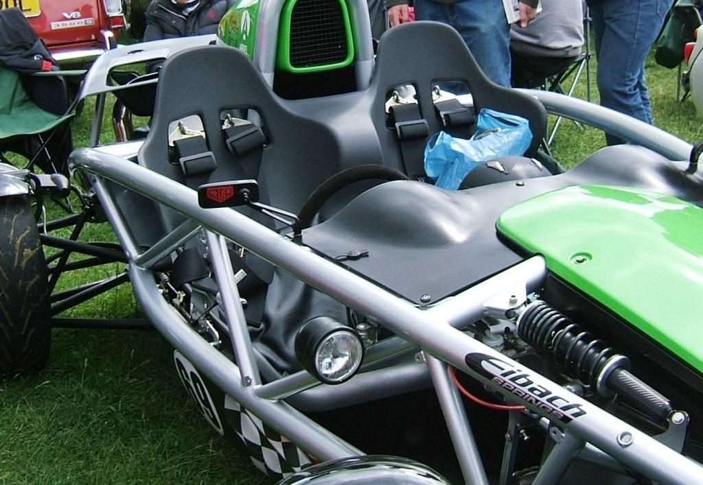

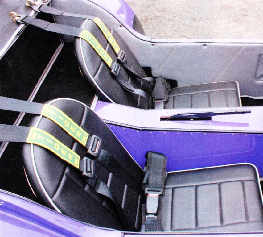

Some seat belt mounting pictures...
As you can see these are all harness systems. They look like they are mounted at seat back height level.
Even so, when I checked the MSVA manual it says that all upper seat belt mountings must be 450mm high above a 136 x 53mm high block placed on the seat base. Lap and diagonal and 4 point harness.
It must be that the seat bases in these cars are very thin, at least for when the test was carried out...!!

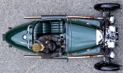

Here is the Morgan 3 Wheeler... This has an interesting seat belt mounting solution.
As you can see the lap and diagonal upper mounting is in the centre of the car... Again it looks quite low, but again the seat base may be thin...
The Morgan is a factory built car and not a self build kit, so presumably complies with all the regs....!!
The MSVA manual says that the upper seat belt mounting position must be such as to prevent the lap belt from slipping off the wearers shoulder..
