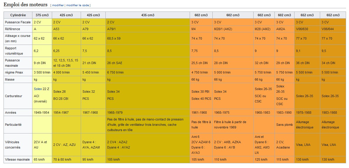

I am surprise that you have a Solex 34 Pics 10 as this one is for 425cc engine, this is unusual for a Lomax I was more expecting a 602cc engine, this might explain the trouble jetting not big enough for example.
For 602 M4 should be Solex PICS 40 2 or 3 rep 44 or 45
For 602 M28/1 should be Solex PICS 34 4 or 5 rep 4 or 5
For 602 M28 should be Solex PICS 26 35

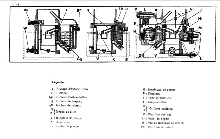

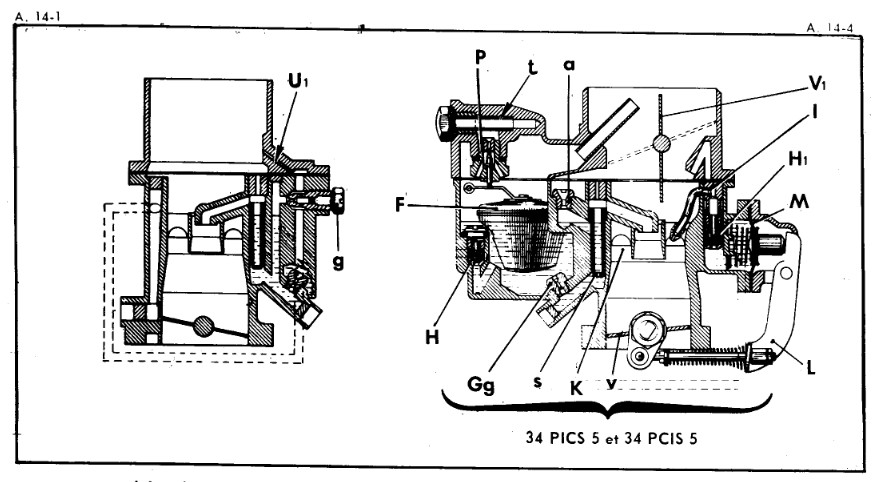

The procedure you are describing is for as you wrote a twin choke carburetor, Thus not valid in this case Tom is having a single choke carburetor "Solex solex 34 pics ref 10". I have rechecked there was such carburetor rep 10 on 602 engine M28/1 AK2 from 1968-1975.
PCIS34 1.JPG (104.78 KiB) Viewed 20095 times
PCIS34 2.JPG (94.31 KiB) Viewed 20095 times
W is the idling mixture screw

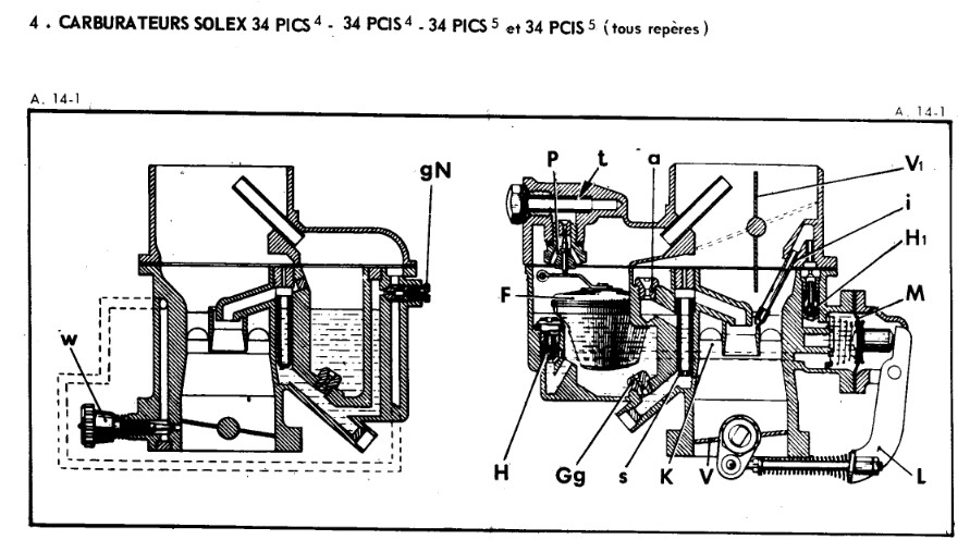

Post by Lomax76 » Tue Aug 27, 2019 1:39 pm
Next...
In this set up:
W Idling mixture
Va Idling air

Citroen's workshop manual states that the Solex 34 PICS 10 carburettor was fitted to M28/1 602cc engines in AY(Dyane), AK (van) and AZ (saloon) vehicles between 7/1976 and 7/1978.
Jetting would have Solex's reference 193 or 194, depending whether or not a centrifugal clutch was fitted.
Solex 34 carburettors were also fitted to the 435cc engines from 1968 onwards.
