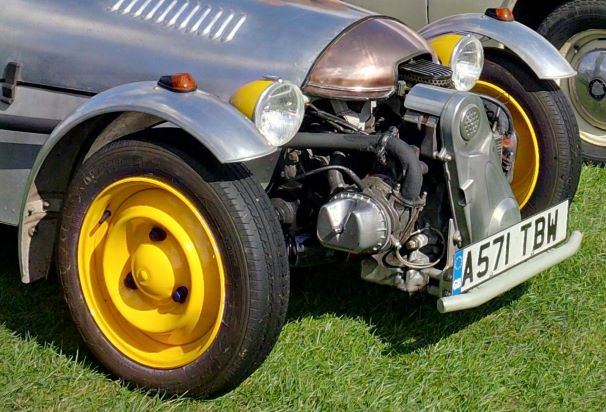

I use the early cast Citroen covers on my 602 engine, they use a different gasket to the pressed covers.
Pembleton Super Sport
- Mudguards Aug 2019 small.jpg (66.99 KiB) Viewed 8714 times

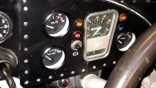

I find with the oil cooler blanked off with Tank tape and using 10/40 oil the engine quickly reaches operating temperature, correct temperature and pressure was maintained on a 70 mile trip last weekend.
- Dash with oil gauges small.jpg (44.72 KiB) Viewed 8649 times
