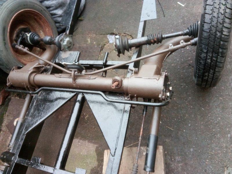

Hi
bought a Lomax 223 in bits and slowly putting it together. Am confused by the anti-roll bar and fittings that came with it (unassembled) it looks completely different to the ones in your pictures - the tapped bosses are welded onto the inside on mine so the only way to fit the bar is behind the steering axle. Is this correct???

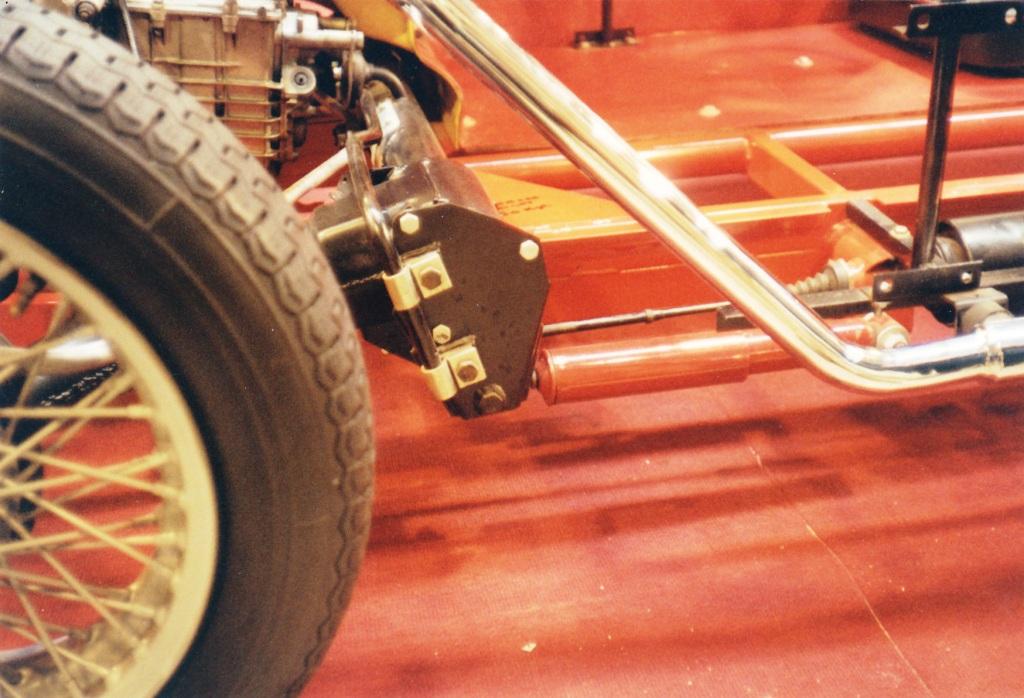

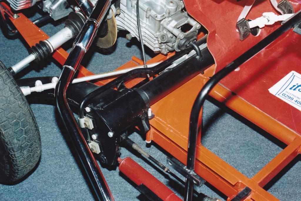

Re: Anti-roll bar
Hi Tom,
Here are a couple of photos taken many moons ago at Stoneleigh of the original Lomax demo with a cut away body tub.
Hope this clears up your roll bar fitting puzzle.

Hi Ken and Howard
thanks for your messages. What I cannot understand is that the mounting plates that fit on the ends of the axle have the bosses welded on the inside edge rather than the front edge as per Howards photos and are handed i.e. cannot be swapped over.

Re: Anti-roll bar
As Ken says you have the damper mounting plates fitted to the wrong ends of the of the axle cross member, i.e. driver side mounting plate is on the passenger side and passenger side is on the driver side. In your photo it looks like the suspension arm is hanging down presumably the car is up on stands. when it is on its wheels all will be at the correct angle. The 3 tapped holes in the ends of the cross member tube are all at about 105mm centres on the same pcd so the plate will bolt on to either end.

Finally realised that this had all been reassembled incorrectly when I bought it. The end plates had been fitted incorrectly hence the issue with the dampers. I switched the plates in the correct position which revealed one rear damper on the front and one front damper........ However still not out of the woods........ the anti roll bar is now on the front BUT it fouls with the gearbox mount! Any thoughts?

Re: Anti-roll bar
Still struggling to get the arb into a position where it is not fouling the gearbox mount. In the photos of the cutaway lomax the arb looks as if it should be behind the gearbox mount rather than neatly behind the gearbox - is this correct.
