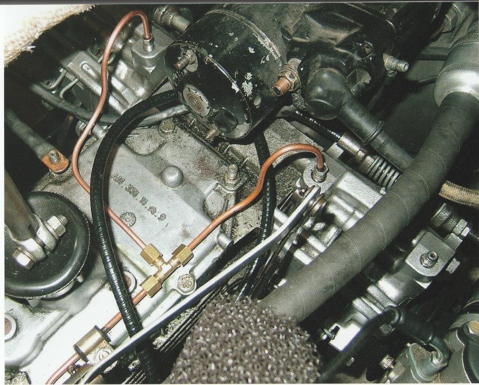

I too suffered from impossible to bleed brakes a few years ago (article in Flat Out Sept-Oct 2017 p25).
Eventually I concluded that the trapped air was somewhere in the front calliper circuit.
My fix was to re plumb the callipers using a tee piece and fitting both callipers with bleed nipples.
It worked first bleed attempt.
