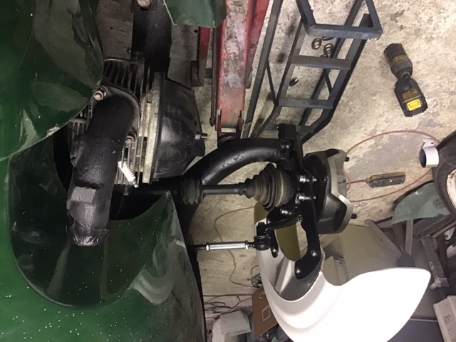

A little more progress.

Interesting hub adaptors Kevin, for Smart fore two wheels? Any info...

Post by notsmartcar » Sat Jan 21, 2023 3:50 pm
Standard fitting on a blackjack avion. From david emery. 👍. Gives wider track thus tighter turning circle more clearance in some cases for an exhaust pipe

Post by AlanM » Sun Jan 22, 2023 10:19 am
I like the mudguard mountings Kevin. Did you weld brackets on the uprights or are the king pin swivels from another Citroen 2CV clone?

Post by notsmartcar » Sun Jan 22, 2023 11:15 am
Hi Alan to save time I just bought them hubs with brackets on/fibre glass wings/brackets complete so they fit perfectly from david emery the blackjack avion parts supplier. The ball joints/Trackrod ends from Howard of course and they are brilliant as well 👍.

Post by AlanM » Mon Jan 23, 2023 10:17 am
Thanks Kevin
I've got some of Howard's TRE's waiting in the wings.

Post by namster » Mon Jan 23, 2023 11:10 pm
Alan,
The Ami had mounts on the front of the swivels for inertia dampers.
On mine I also had some rear mounts made up and welded on too. I made some wing brackets out of some barstock, angle and plate.

Post by AlanM » Tue Jan 24, 2023 1:29 pm
Thanks Niall
I thought that I had read somewhere that one of the clones had such brackets. It is of interest only at the moment as I have some NOS original brackets that mount on the TRE points. Mind you I have also heard that these are prone to faults. Time will tell.
