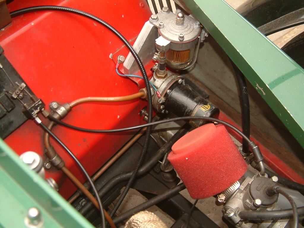

Hi Guys - I thought you might be interested I am going through everything methodically. My present fuel system has a Facet posiflow 60104 pump sited adjacent to and in front of the tank (at the bottom). There is an in-tank strainer so I have removed the pump strainer at the suction (very recently). It sucks through 6mm copper pipe and fuel hose. The outlet is 6mm copper and hose which flows to a fuel filter king. The next inline is a gauge, the line then splits to feed the Dellortos (PHBH 28).
When the pump runs a pressure of 2.3psi shows on the gauge. I have attempted to adjust the fuel king but the pressure stays at 2.3psi. I have stripped the fuel king and it looks ok.
Then I placed a 8mm hose bypassing the Fuel King. I blocked off the fuel hose which feed each of carburettors. I started the pump which pumped to 2.3psi. (Closed system).
I unblocked the hose to the furthest carb and lead it to a 5 litre petrol can to check the flow rate of the pump. I calculated the flow rate to approx 13 US gallons per hour. The pump specification indicates a flow rate of 26 US gallons per hour. The pump specification also indicates a pressure range of 1.5psi to 4psi. The thing is the pump is still in range of the requirements of the engine however I am wondering whether when considering connection to the 2 carbs etc perhaps this could be my problem. Your thoughts would be appreciated?? Anyone using Hardi fuel pumps? They are German and work on the same principal and pressure as SU pumps. Cheers Steve
